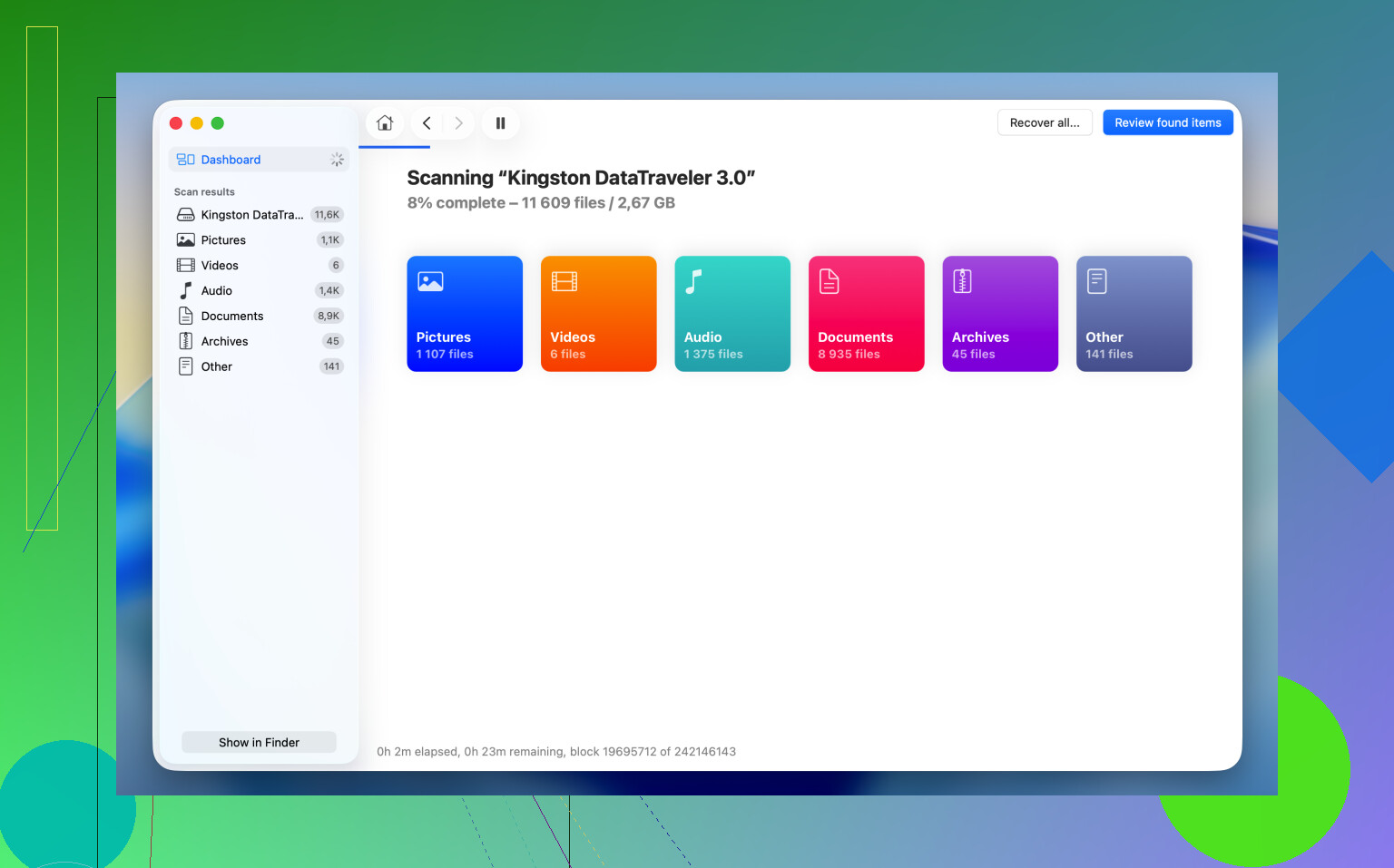

My usual move is to pull data off before I try to fix the mount issue. For drives that appear in Disk Utility but won’t show up in Finder, I’ve had decent results with Disk Drill. macOS tends to give up fast when the file system is messy. Disk Drill reads the storage device more directly and scans for recoverable files.
The part I keep coming back to is the Byte-to-byte Backup feature. If the drive is acting weird, disconnecting at random, or feels unstable, I make an image first. That copies every readable sector into an image file, so you work from the copy instead of hammering the original disk over and over.
The recovery flow is simple enough:
1. Download and open Disk Drill.
2. Select the unmounted drive from the list.
3. Create a Byte-to-byte Backup first if the drive seems unstable.
4. Scan the drive or scan the backup image.
5. Review the found files.
6. Preview important files and make sure they still open.
7. Recover them to a different storage device.
