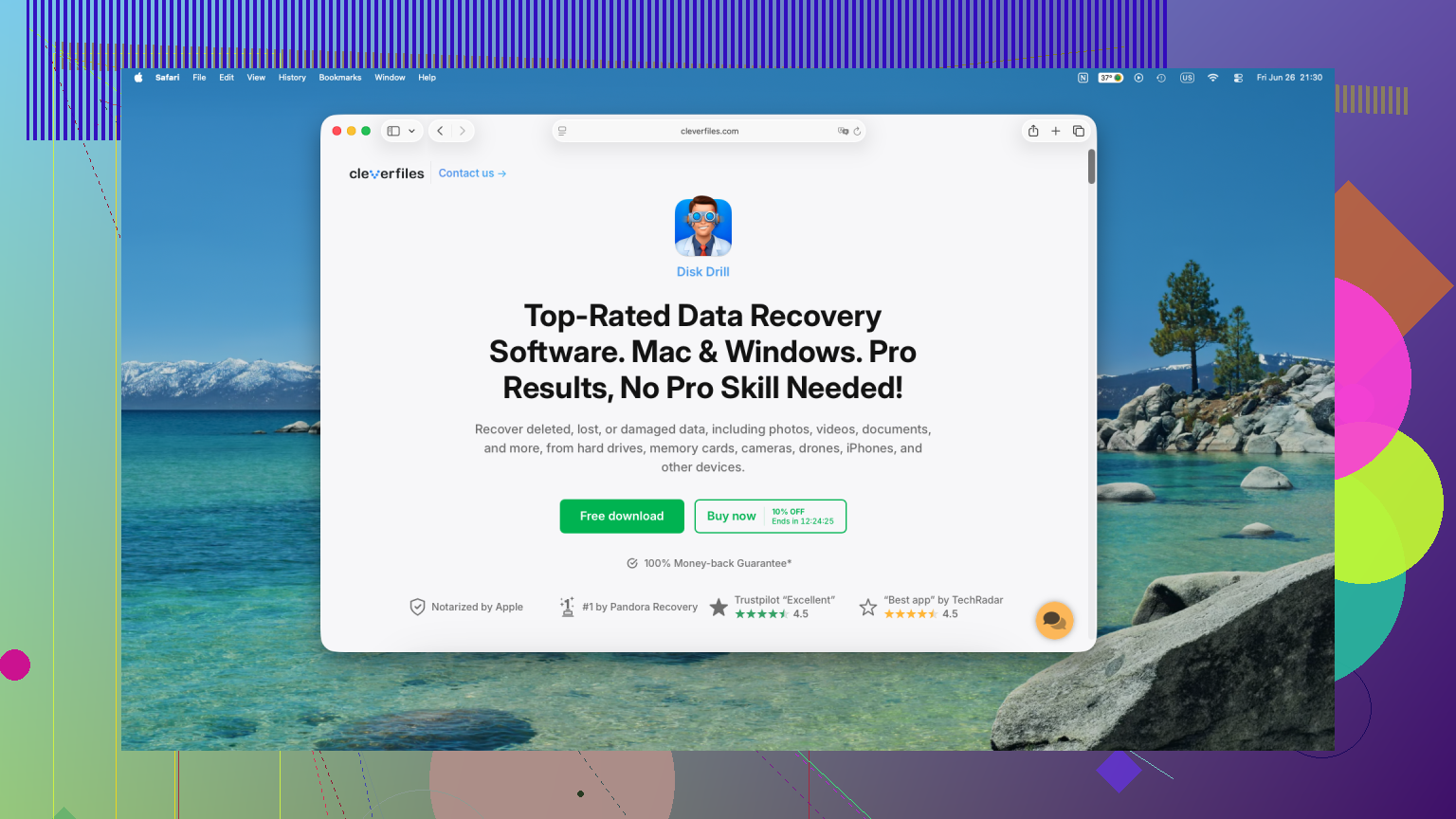

3. Recover your files before doing anything else
I’d usually begin with Disk Drill. It’s easier than some of the other tools, and from what I’ve seen, it handles RAW volumes decently.
The steps are pretty plain:
  1. Install Disk Drill on your PC, not on the damaged USB drive.
  2. Plug in the USB drive.
  3. Select the drive inside Disk Drill and press Search for Lost Data.
  4. Let the scan run to the end.
  5. Go through the results by folder view or file type.
  6. Preview anything important.
  7. Recover the files to a different drive.
On Windows, the free limit is 100 MB of actual recovery. Scanning and previewing aren’t capped, which helps a lot because you get to see what’s there before spending money. In my case, previews matter more than the marketing page. If a tool shows my PDFs correctly, opens photos, and reads video headers, I trust it more. Disk Drill usually previews common stuff fine, documents, PDFs, images, video files, archives, and a bunch of RAW photo formats too.
If the results look incomplete, I wouldn’t stop there. I’d run a second pass with UFS Explorer or DiskGenius. Different recovery tools pick up different leftovers. I’ve had one tool miss an old folder tree, then another one found it on the same drive five minutes later. Annoying, but true.
