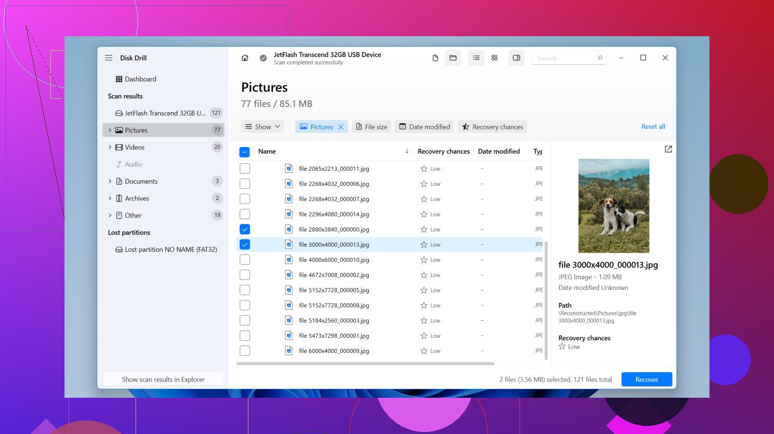

If you do not have a backup, recovery software is usually the first thing to try. I had decent luck with Disk Drill. It recognizes Nikon file types like NEF, NRW, and JPEG, and I did not need to poke through a pile of settings to get started.
Here is the process I would follow.
  1. Take the SD card out of the Nikon.
  2. Plug the card into your computer with a card reader.
  3. Install Disk Drill on your computer. Do not install it onto the SD card.
  4. Pick the SD card in the app and click Search for lost data.
  5. Use Universal Scan. In my case, it worked fine for deleted photos and quick-formatted cards.
  6. When the scan ends, preview the images. If they open and look normal, recovery usually goes better.
  7. Save recovered files to your computer or another drive. Do not put them back on the same SD card.

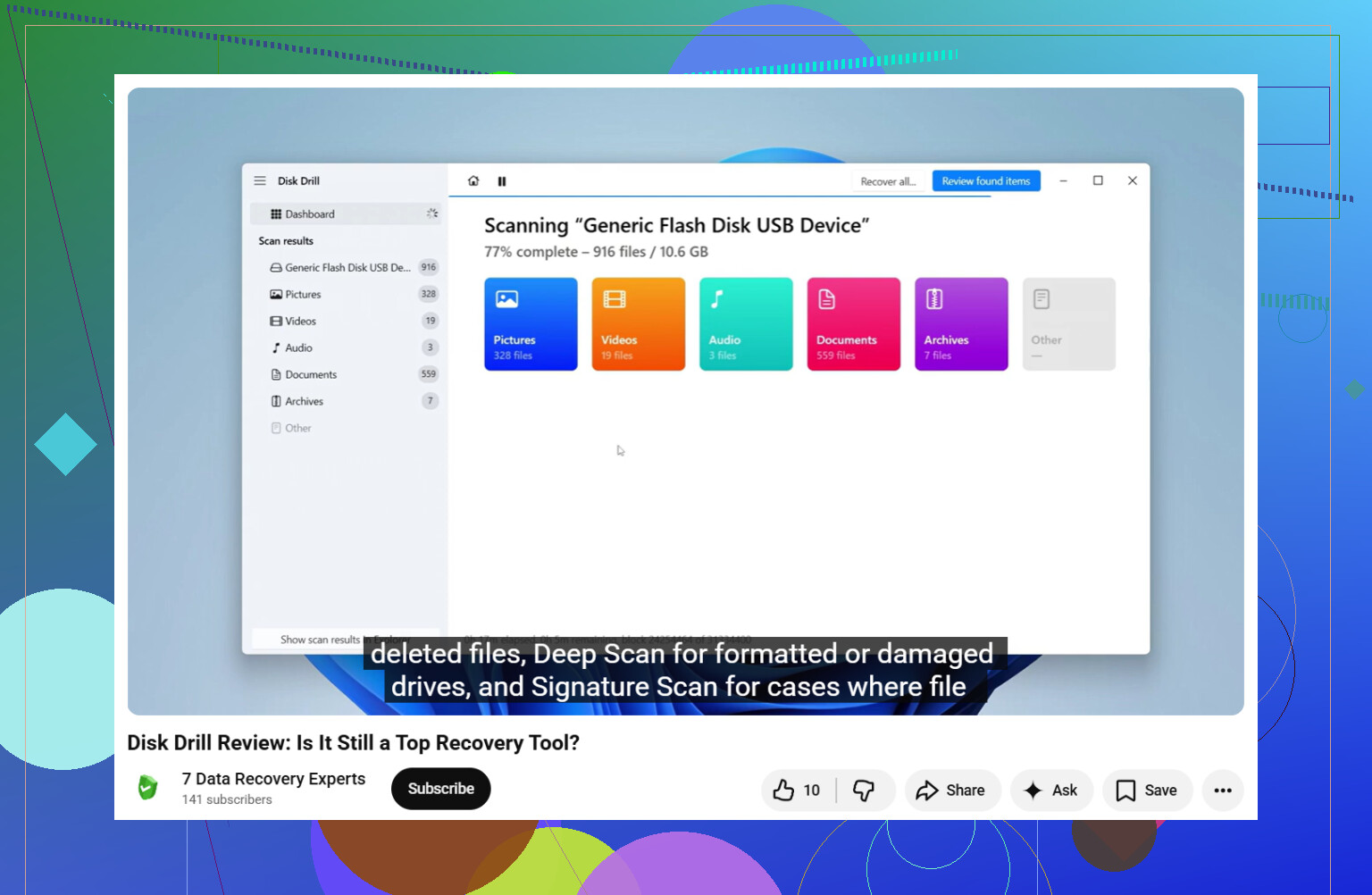

If you want a decent explainer, this is worth a look, Disk Drill review with real recovery tests.
